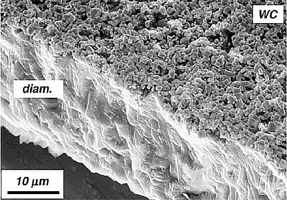

DATRON uses a specialized coating application for their tooling known as CVD or Chemical Vapor Deposition. The purpose of the coating is to protect the overall shape, sharpness and precision of the cutting flutes. These flutes are the surfaces which engage the material that is being cut. The Flutes are coated in diamond or diamond-like carbon material which enhances the overall life of the individual tool. However, sometimes a rounding off of flutes can occur from sub-standard CVD application. DATRON’s scientific and patented procedure has allowed for a perfect equilibrium between the chemical adhesion of the coating to the cutting surface of the tool. Please note the electron microscopic image presenting the CVD adhesion to the carbide tooling showing an exact and accurate deposit of diamonds to the carbide surface.
Dental milling tools with diamond coating produced with CVD (Chemical Vapor Deposition) shown in this electron microscopic image.
