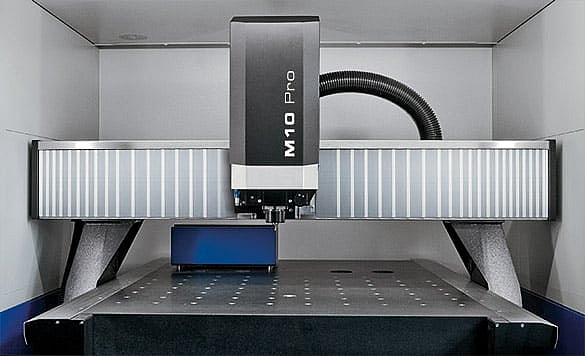

Linear scales add to a machine’s precision and consistency in holding tight tolerances.
6. Linear Scales for Holding Tight Tolerances
If all else fails, scales! – If you have done everything on this list, and you still struggle, it may be time to consider getting a machine with linear scales. Your typical CNC machine will use the drive motor encoder as the primary method for keeping track of its absolute position, but this can be flawed due to imperfections in the ball screw or thermal discrepancies. Linear scales change all that – typically installed at the factory, they consist of two main components – the scale, and the read head. Put simply – the scale is like a highly accurate ruler that the machine can read, constantly comparing and adjusting for deviations. On our M10Pro, this allows for a 25% tighter positioning tolerance, a 20% improvement in repeatability, and a 85% reduction in backlash.
The DATRON M10 Pro features linear scales for added precision and accuracy.
