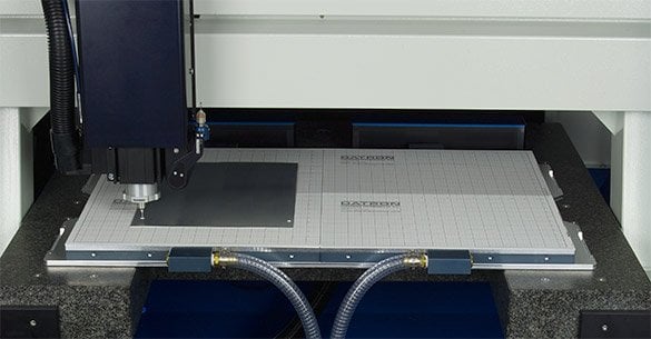

Absolute Movement – used to move the machine from a random location at the back of the work area to the zero point (in this case, top of the left front corner of the workpiece).
Let’s run through an example. We’ll work on the assumption that you have a fixture and workpiece set up on your machine, and your zero point is the front left corner, with top of stock being Z zero. You just finished setting up your tools so you are located near the back of your table at some random coordinate. We will pretend that your program starts from X0 Y0 Z0.5. So here is your dilemma – you are currently at X6.753 Y14.265 Z2.37 and you need to get to X0 Y0 Z0.5. How will you do it?
Should I use Absolute or Incremental?
Well, technically you can use either absolute movement or incremental movement. To make this incremental movement you would enter X -6.753 Y-14.265, and then you do some math. You are currently at Z 2.37 and need to reach Z 0.5. 2.37 – 0.5 = 1.87. So for your Z input, you would enter Z -1.87. This would get you to X0 Y0 Z0.5. On the flip side, if you make an absolute movement your input will be X0 Y0 Z0.5. You are telling the machine “I want to move the X axis to 0, I want to move the Y axis to 0, and I want to move the Z axis to 0.5.” This is where the real benefit of an absolute movement comes in. When you are moving TO A POINT, absolute is the much simpler way to go.
