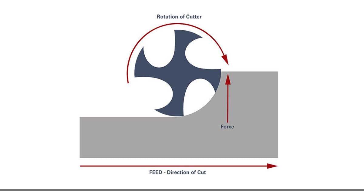

With the tool rotating clockwise, conventional milling goes AGAINST the rotation. The flutes of your cutter are hitting the material and pushing against the rotation, depositing chips IN FRONT of the cut. As expected, that will result in re-cutting the chips, which will both increase tool wear and decrease surface quality. Since the tool hits at the bottom of the part and the flute cuts upward with the chip getting heavier as it cuts, you are creating upward force on the part which can cause workholding issues.
Conventional Milling – offers a significant benefit when machining hard materials like cast iron or hot-rolled steel.
Just as there are downsides to climb milling, there are upsides to conventional milling. When machining things like rough cast iron or hot rolled steel, conventional milling is the preferred method. Especially with hot rolled steel due to the hard black layer on the outer surface. Performing a climb mill on hot rolled steel can result in chipped cutting edges because of the hardness of that outer layer and the more aggressive way the tool engages the rough surface, causing more deflection and potentially heavier chips. Since the tool deflection with a conventional mill tends to be parallel to the tool, it engages the rough surface at a more forgiving rate. Another strong suit of conventional milling is on finish passes. If you rough your profile with a climb mill, which will give you a good surface finish to begin with, and then switch it up on the finish with a light conventional mill you will be surprised by the results. Due to the tool deflection seen with climb milling the conventional mill finish pass will give you a good finish on a light pass. Another option is a “ghost pass” or “spring pass” which is a cut in the opposite direction, in this case conventional, without actually taking a heavier cut. You will see the amount of material being removed, which was left by the tool deflection and it will leave a great finish as long as you lubricate.
