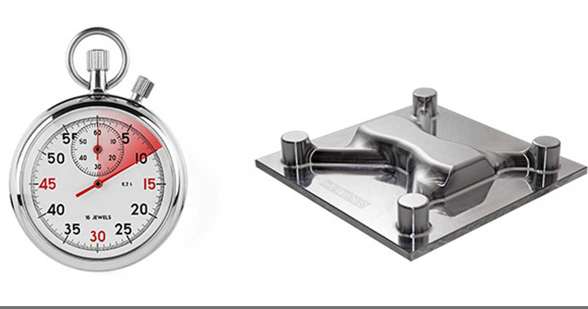

I’ll illustrate the range between Dynamic 1 and Dynamic 5 by milling the part below.
Aluminum part programmed to illustrate the difference between dynamics settings.
On Dynamic 1 you can mill one of these parts every 8 minutes 40 seconds Not bad, but on Dynamic 5, each part is milled in 6 minutes 3 seconds. In both instances, the spindle speed is 40,000 RPM and the feed rates are 4 m/min. with a 6mm single flute end mill and 3 m/min. with a 3mm single flute end mill. So the only variable is the Dynamic setting.
