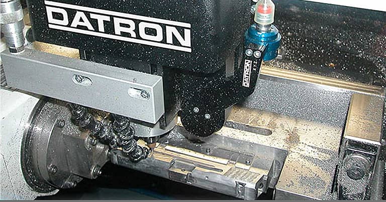

![](https://www.datron.com/cdn-cgi/image/width=430,height=630,fit=crop,quality=70,gravity=auto,sharpen=1,metadata=none,format=auto,onerror=redirect/wp-content/uploads/2022/11/blog-Halftone_Engraving-1.jpg)
