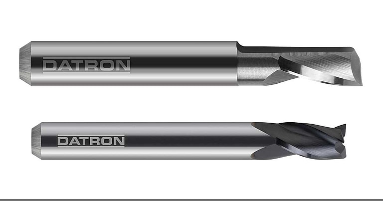

With the aluminum grade locked down, you can start to choose your cutting tools. Always choose the shortest tool available to accomplish the job. Using a longer tool you have on hand may seem more convenient than ordering a shorter one, but you will regret the decision when your finished part is covered in chatter marks – a telltale sign of tool deflection.
Also, consider your CNC machine configuration before making your tool decision. A typical, low RPM machine will benefit from higher flute count tools, but will in turn suffer from low efficiency and higher cutting forces. With a high RPM CNC machine, like a DATRON, a lower flute count tool (single flute, ideally) becomes a good choice for reducing cutting forces and allowing for excellent chip evacuation.

One last tip on tools: When milling aluminum, consider uncoated tools. Using coated tools may seem like a no-brainer, but take note: Coatings add a thin layer of material over a sharp cutting edge, thus rounding it over. This may work fine for harder materials, but when cutting softer grades of aluminum, you run the risk of “galling”.
Galling is evident when aluminum builds up on the rounded edge because the tool is not sharp enough. It leaves a distinct smearing of aluminum at the cutting edge. This can lead to accelerated tool wear and poor milling results. The sharper the tool, the lower the cutting forces and frictional losses. This yields a more efficient use of the spindle’s available horsepower, which leads to a longer tool life, faster cycle times, and better looking parts.

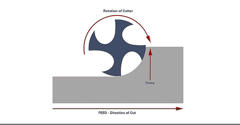

Watch out for inherent stresses within the material. Different types of aluminum come with their own stresses in the material, owing to the processes used to manufacture it. For instance, extruded 6061 aluminum suffers higher internal stresses compared to MIC-6, which is cast.
This matters when it comes to process reliability and holding finished tolerances. Cutting into stressed material can result in warping, commonly referred to as “bow” or “potato chipping”. When milling one side of a stressed material, the internal forces become uneven, causing it to twist. Choosing your tools, material, workholding, and strategies wisely will help to mitigate these stresses.
