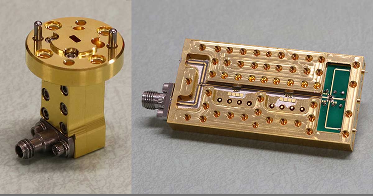

Nestled in the outskirts of Seattle, amidst a quaint residential neighborhood, you’ll find a rather modest garage that is packing some serious manufacturing capability. This little workshop is the home to BNC Engineering, a business specializing in RF, microwave, and millimeter wave test equipment, and capable of manufacturing RF Waveguides. Today, we’ll get a low-down on the history of BNC Engineering from the founder, Sergey Klypin, and why he chose DATRON for his in-house machining needs.

Besides struggling to find a shop that was willing to deal with their high mix, low volume, and frequent rework jobs, the RF waveguide parts being made were not familiar to machinists. “Job shops understand mechanical parts; these are fundamentally electrical parts that simply have a mechanical manifestation. They would really be closer to circuit boards”.

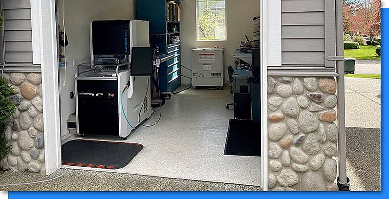

Besides the minimal machine footprint, the neo had other significant advantages for BNC’s small workshop. Single-phase power capability made setup in a residential neighborhood easy, as well avoiding the expense of hooking up industrial 3-phase power. Another important benefit, for Sergey and his neighbors, was the minimal noise pollution. “I do have neighbors nearby, not one of them has complained.” This is a hallmark of milling with a DATRON; a rock-steady machine combined with a high RPM spindle equals peaceful production.
The neo’s ethanol coolant system was another distinct improvement, since it’s significantly easier to work with when compared to traditional flood coolant systems. “(Flood coolant) It’s corrosive, it’s moldy…. It’s a pain.” Another great point is the ease of maintaining the ethanol system for a small-scale production machine. A machine with flood coolant will require more maintenance, even when not being used. “It (flood coolant) also doesn’t scale; Fundamentally, ethanol scales. You cut two days out of the month, you use it two days out of the month. With (flood) coolant you bought the farm, it’s got a lifetime.”
