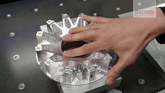

Deburring with Chamfer Mill on DATRON neo
First, select the appropriate tool based on the material and the type of burrs you need to remove. Common tools include end mills, countersinks, and deburring cutters. The choice of tool will depend on factors like the material’s hardness, burr size, and the desired finish. DATRON offers quality carbide tools that are German engineered for precision, performance, and extended tool life, which is perfect for deburring projects, but we will cover more on tools later in the article.
Next, you will need to program the CNC machine. Load your workpiece into the machine’s workholding system, ensuring it is securely fixed. Create a CNC program that specifies the toolpath for deburring including information about the tool’s speed, feed rate, depth of cut, and toolpath strategy. Use CAM software to generate the toolpath if you’re not manually programming the CNC machine.
The choice of toolpath strategy depends on the geometry of your workpiece and the location of burrs. Common strategies include contouring, chamfering, and face milling. Ensure that the toolpath covers all areas with burrs, and that the tool approaches the workpiece at the correct angles to remove the burrs effectively. Set the appropriate cutting speed (RPM) and feed rate (inches per minute or millimeters per minute) for the chosen tool and material. Be sure to regularly inspect the cutting tool for signs of wear and replace it as needed to maintain the quality of the operation.
The last step is to begin running the CNC machine and closely monitor the operation to ensure that the burrs are being effectively removed. After deburring, inspect the workpiece to verify that all burrs have been removed to the desired level and make any necessary adjustments to the CNC program if burrs remain.
